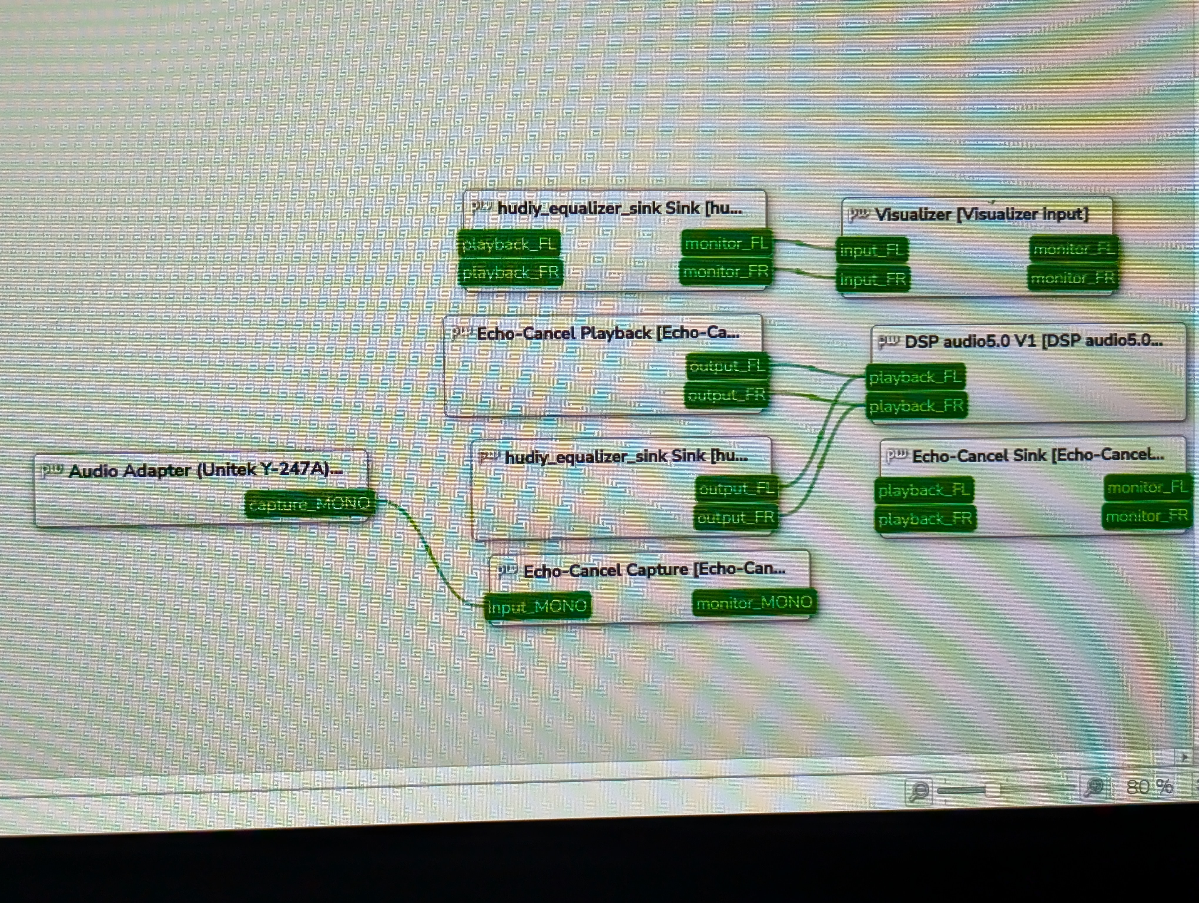

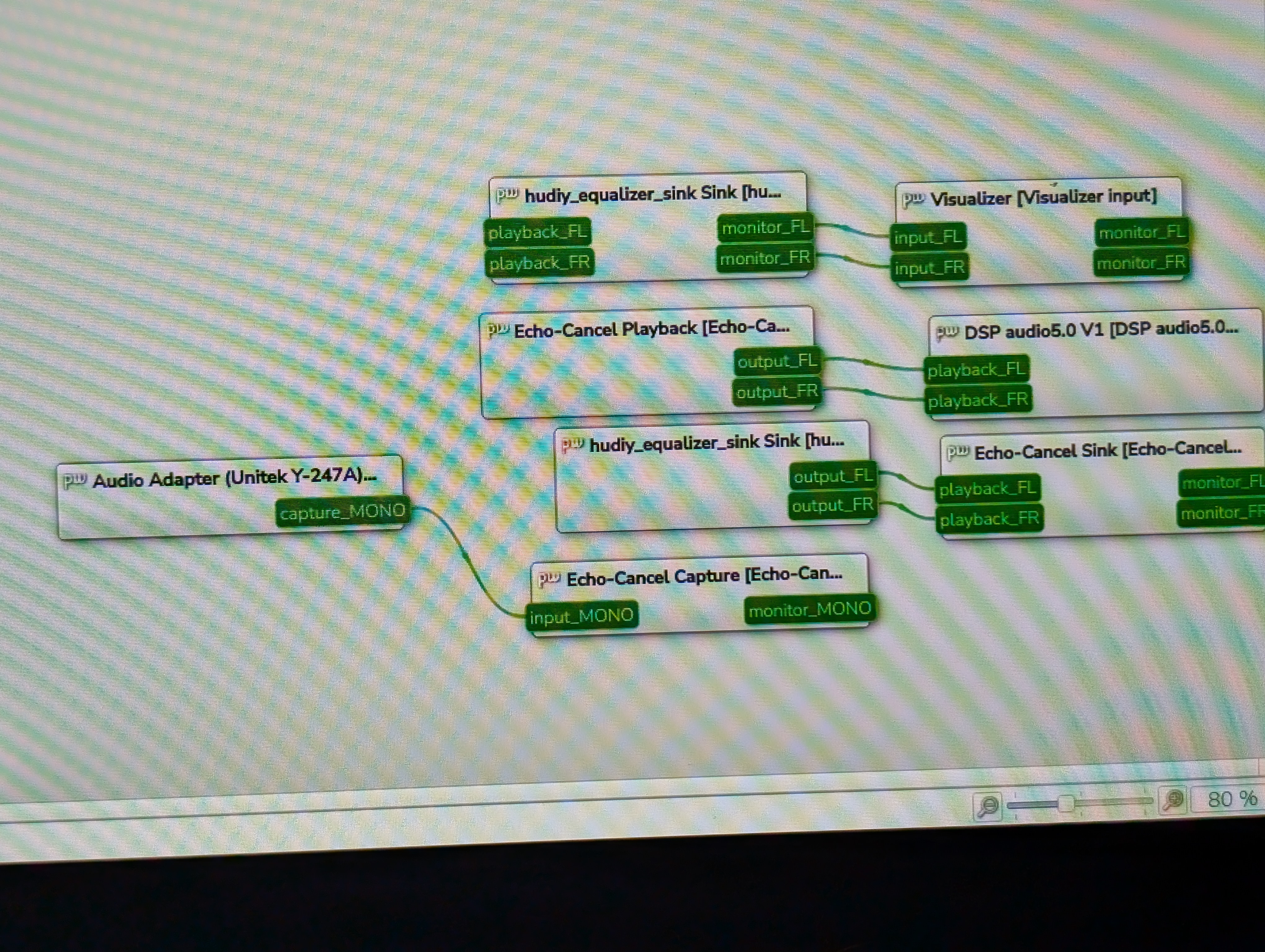

I'm still having issues getting the Bluetooth DSP to be the default device that Hudiy outputs to after the eq sink. I am still having to manually select it in the desktop. Once I do, the output is spotty and distorted.

Here is wpgraph before and after manually selecting the DSP as the audio output.
Re: After 2.4 update
Posted: Sat Jan 24, 2026 6:46 pm
Actually "before" routing looks pretty good. There is no sink inputs visible in qpwgraph but we assume hudiy_equalizer_sink is the default one. What is the behavior when "before" routing is active?

If audio is playing via hudiy_equalizer_sink (according to visualizer behavior), then based on the routing, it should also reach the DSP audio5.0 V1 sink. It looks like the issue is somewhere after DSP audio5.0 V1.
Is DSP audio5.0 V1 a USB or a Bluetooth device? What is the output of pactl list sinks command for the "before" routing?
Posted: Sat Jan 24, 2026 8:21 pm
Could you please also connect your visualizer to the echo cancel sink monitor and the DSP audio5.0 V1 monitor? That way, we'll have a full picture of whether audio is definitely passing through these two sinks.
