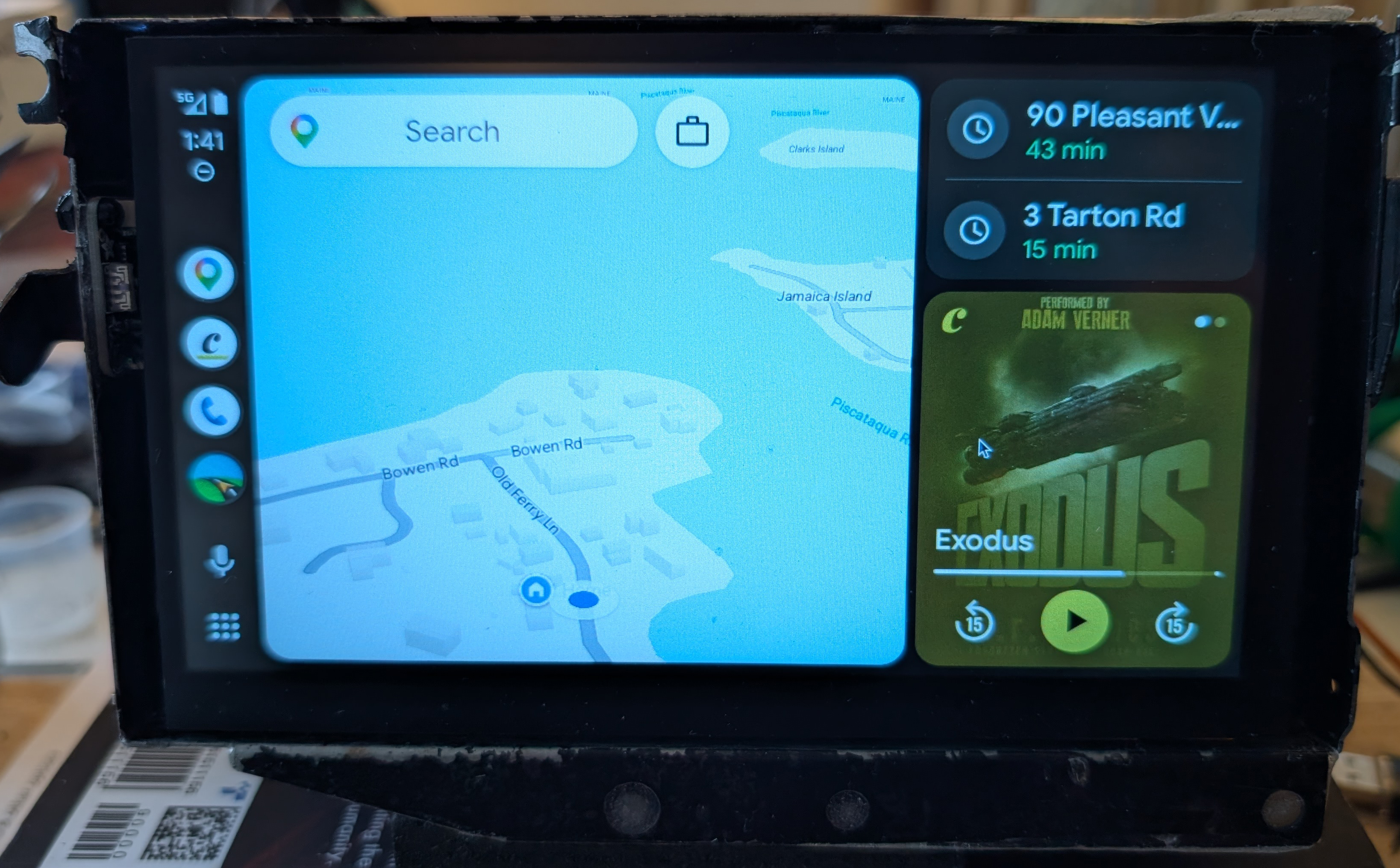

After some hardware modifications and a complete software reload ( I totally bollixed up the safe shutdown software) CarPC running Hudiy is ready as I can make it right now.
Safe shutdown (10 seconds delay) works
Backup camera works by manual selection
Android Auto works and fits the screen well
SDR (software defined radio) works
I need some community help on getting automatic operation/deactivation of the backup camera (by sensing rear backup lights are activated/deactivated).
and some better details on how implement raising and lowering the cars antenna when FM is selected for the music source.
