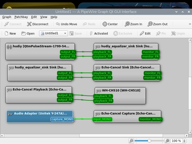

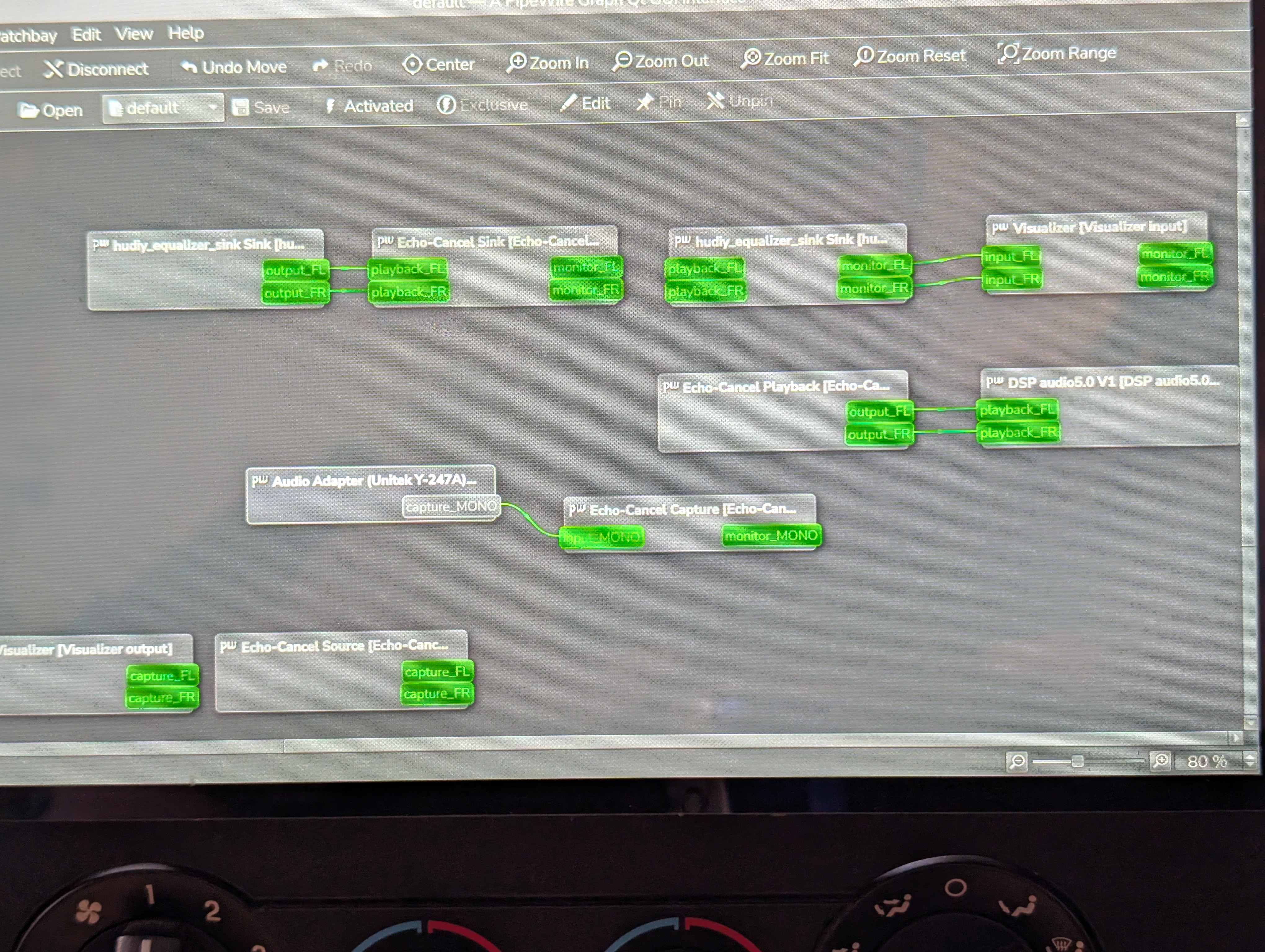

Now i understand why qpwgraphs flow looks the way it does after boot. Its the correct way.. I get audio now for some reason, it is crackly and a little quieter than expected but it seems to work. idk why now and not before.
Any ideas into the crackling at volume change? it seems to be the most audible while AA is open.
Re: After 2.4 update
Posted: Sun Jan 25, 2026 5:48 pm
We tried to reproduce your setup. We connected headphones instead of a Bluetooth amplifier, but it should work the same way from PipeWire's perspective. Everything worked out of the box and we didn't observe any audio glitches. The routing generated by PipeWire looks identical.

hudiy wrote: Sun Jan 25, 2026 5:48 pm We tried to reproduce your setup. We connected headphones instead of a Bluetooth amplifier, but it should work the same way from PipeWire's perspective. Everything worked out of the box and we didn't observe any audio glitches. The routing generated by PipeWire looks identical.
Could it be that I dont have a defined source? I see you have the qtm-pulse stream.. set as input to the hudiy_equalizer_sink.
Posted: Sun Jan 25, 2026 7:43 pm
QtmPulseStream on the screenshot is just a sink input (in this case from Android Auto). Sink inputs appear automatically once you start playback in any app (Hudiy, web browser, vlc, etc).
We also checked the PipeWire GitLab and found several issues regarding Bluetooth devices where volume control doesn't work. It’s possible your amplifier is one of those devices:
https://gitlab.freedesktop.org/pipewire ... ssues/3786
https://gitlab.freedesktop.org/pipewire ... ssues/4793
https://gitlab.freedesktop.org/pipewire ... ssues/3225
You can try to add your device to the /usr/share/spa-0.2/bluez5/bluez-hardware.conf and check if that helps.
{ address = "~^e9:a7:26:", no-features = [ hw-volume ]},  # DSP audio5.0 V1

I had a feeling I might be experiencing interference with bluetooth. I put a usb bluetooth adapter and swapped over to it and, everything works as expected. I had read somewhere that usb 3.0 devices interfere with bluetooth on the pi4, I'm using a usb 3.0 drive to boot from.
Would adding my device to ~/bluez-hardware.conf be advantageous?
Posted: Sun Jan 25, 2026 8:20 pm
If it is not the issue with volume control then you shouldn't modify bluez-hardware.conf.
If your setup works stable with external Bluetooth adapter it might indicate some incompatibility between your amplifier and built-in BRCM chip.
Kernel communicates with built-in Bluetooth chip via PL011 UART which seems to be unrelated to the USB.

Some weird behavior, audio still wont automatically play through the bluetooth dsp. A few days ago i could get audio to work by selecting the dsp in the audio dropdown and then going into Hudiy. This is qpwgraph after selecting it https://imgur.com/sVEixzk and here is a video and a few pictures showing what qpwgraph looks like immediately after exiting Hudiy.
https://imgur.com/SeZscUk https://imgur.com/B8bxgiU https://imgur.com/FV2T0Rz
https://imgur.com/5JgQQvu
However, now, (I changed nothing) I still have to select the dsp from the dropdown but qpwgraph looks like this https://imgur.com/vvHOFVj and it looks like this after exiting Hudiy https://imgur.com/cGkRdHA
Posted: Fri Jan 30, 2026 7:32 pm
Does your amplifier always connect to Bluetooth before Hudiy starts? Looking at qpwgraph, it seems like sometimes the echo cancel and equalizer load before the amplifier connects, causing WirePlumber to create different routing.
You could try adding a wait for a specific sink before Hudiy starts. Alternatively, you can specify a specific master for the echo-cancel module:
hudiy_startup.sh
AMP_SINK="bluez_output.E9_A7_26_03_1E_82.1"
while ! sink_exists "$AMP_SINK"; do
done
sink_exists "$EC_SINK" || pactl load-module module-echo-cancel aec_method=webrtc aec_args=\"voice_detection=false\" source_name="$EC_SOURCE" sink_name="$EC_SINK" sink_master="$AMP_SINK"
Also remove the wireplumber cache:
cd $HOME/.local/state/wireplumber
rm -rf *
