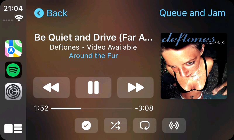

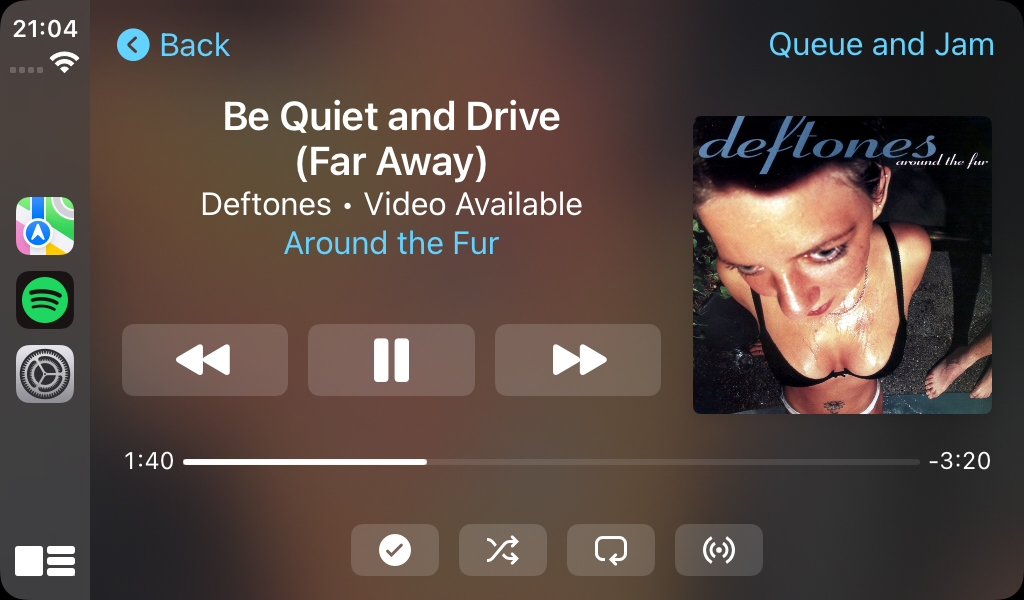

We found a possible issue. On some displays, Raspberry Pi OS forces a 16-bit color depth for OpenGL surfaces, which can indeed cause color banding. We managed to find a screen where we were able to reproduce the problem you're likely describing. We'll include a fix in the upcoming release.
Wrong bit depth:
Correct bit depth:

also small observation that, interestingly there is different scaling across these two images. how do i get the smaller scaling rather than the first image where its massive. are these two screenshots from the same screen.
