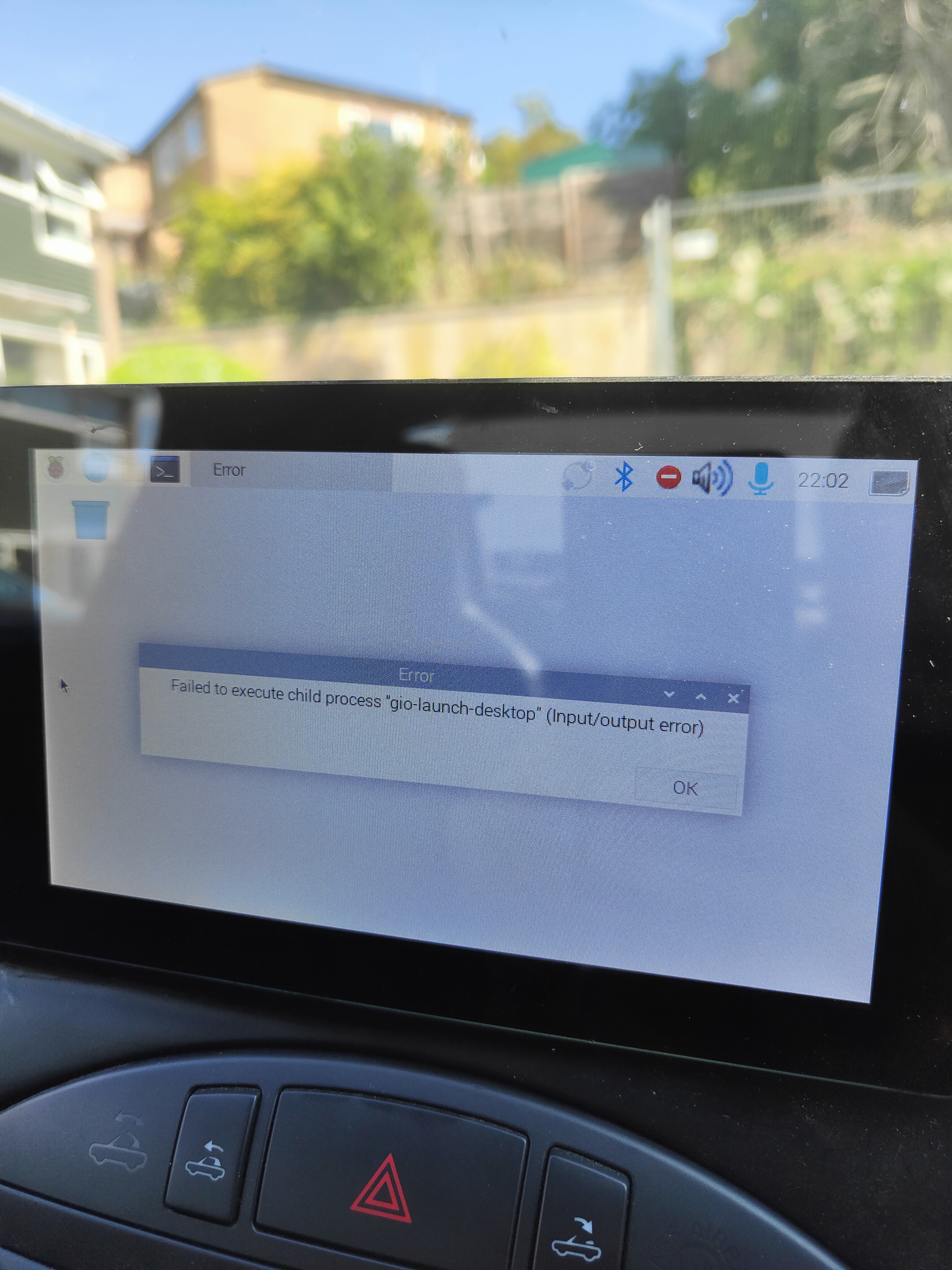

Having said my part above about my carpihat system, I have been having a weird issue where I get a GIO-LAUNCH-PROCESS (INPUT/OUTPUT ERROR) crash and can't do anything.
Fresh install and only things I've changed this time is add my DAC in /boot/firmware/config.txt
And added a python script detecting gpio25 so when I turn the engine off it should safely shutdown the pi (WORKED FINE ON MY OPENAUTO PRO BUILD) but that seems to not work either.
And running SSD so should be less corrupatble

This kind of error and the way the desktop looks suggest that your USB drive lost connection to the Raspberry Pi. You can try disconnecting it manually to see if the effect is similar. Check the power supply to your Raspberry Pi - it seems that under certain conditions, the voltage drops enough for the Raspberry Pi to cut off power to the USB ports.

Thanks for the reply on this. My CarPiHat Pro latches power with octocouplers and takes perm live and acc 12v so no issues with the Pi itself.Though I have a 5v usb hub plugged into the buck converter which only turns on when acc and the ssd is plugged in through this... So assume when it cranks or turn engine off the ssd stops working or loses connection 🤔
