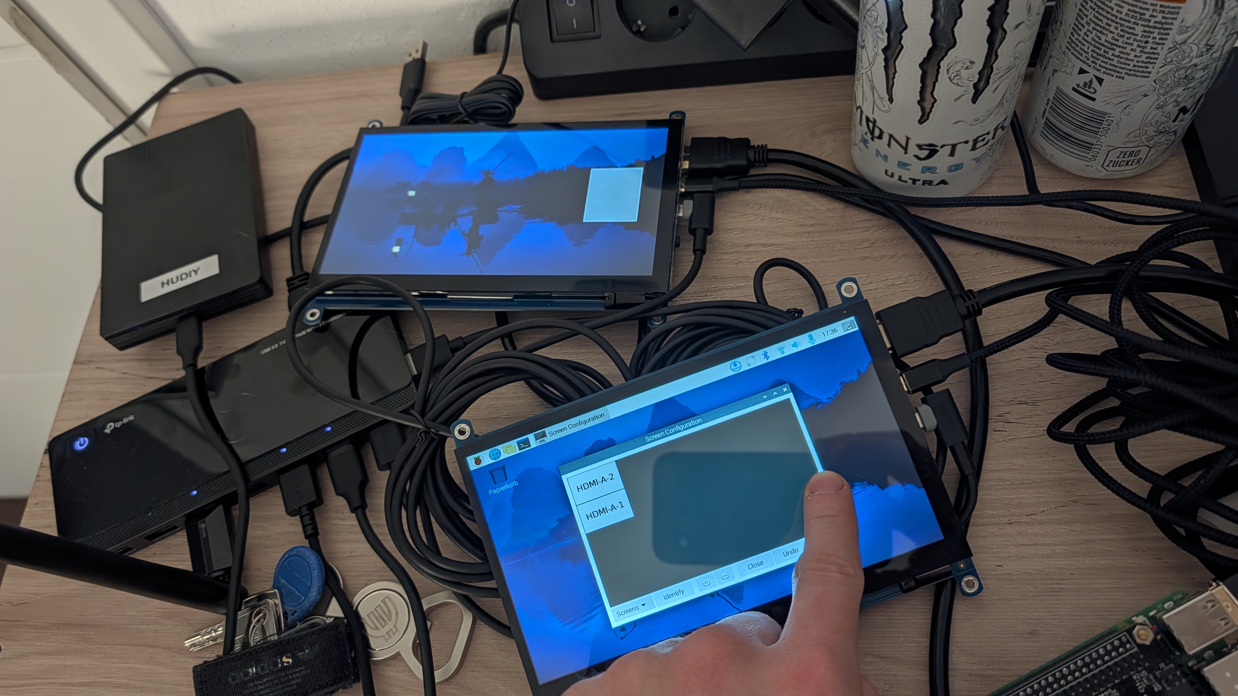

I have a Raspberry Pi 5 Running Hudiy on
Linux hudiy 6.12.47+rpt-rpi-2712 #1 SMP PREEMPT Debian 1:6.12.47-1+rpt1~bookworm (2025-09-16) aarch64 GNU/Linux
I have two Waveshare 7" displays installed (https://www.waveshare.com/wiki/7inch_HDMI_LCD_(C)). One on top, one underneith. They have a resolution of 1024x600 each. So this is my main_configuration.json

On the top display, there is Hudiy UI and if Android Auto is connected, its displayed on the lower display. Works perfectly fine. My problem is, that the touchinputs from the top display register on the bottom display. The touch of the bottom display are also on the bottom display. If I go in the screen configuration, there is a touchscreen configuration. You can check the Waveshare touchscreen for this display, but it checks both at one. Please see the attachments :) So both inputs get redirected to one display. Can please help me get rid of this?
Thanks in advance!

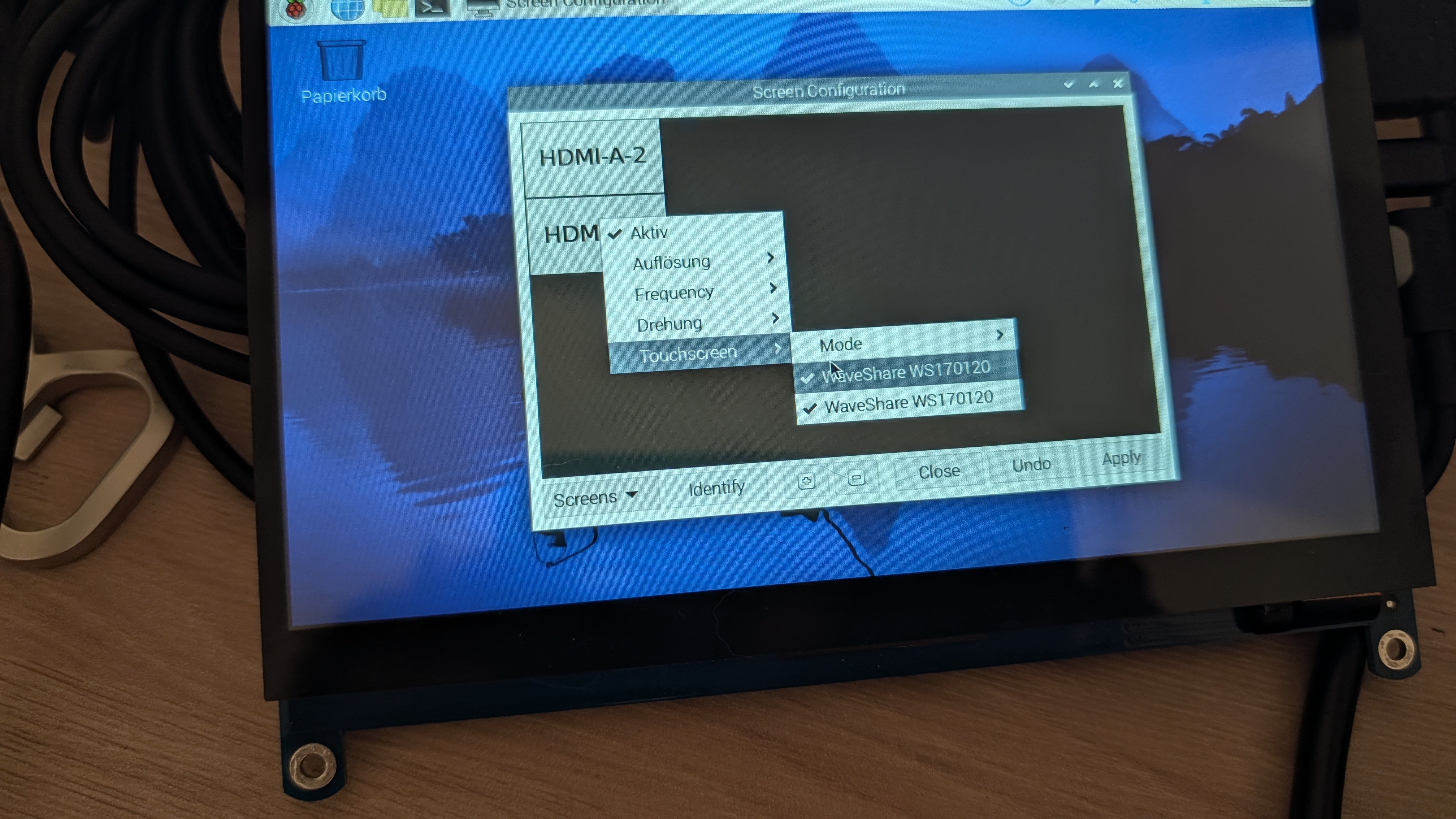

touch registers on wrong display
screen configuration touchscreen (if you select one, both get checked)

What happens when you select one of the touch inputs to the other screen? Is it possible?
Labwc stores mapping of touch inputs in $HOME/.config/labwc/rc.xml. If it is not possible to assign the touch input via Screen Configuration Tool, you can try to do it manually in mentioned file.

thanks for the hint and sorry for the late reply. I tried a LOT of stuff, nothing helped. So a short summary about the actual problem:
In the Raspberry Pi Screen Configurator, there are thow "Touch-Devices" with the exact same name. If i select HDMI-A-1 and bind the touchdevice to it, it works. If I use the touchscreen of the second display (HDMI-A-2), it works also on HDMI-A-1. Same vise-versa.
The main problem ist labwc, which is only able to work with the name of the device. But the name of the touchinput is the same. Unfortunately the name ist one of the rare attributes, you can't change with udev rules. I tried to do so. Creating symlinks via udev-rules for the physical addresses of the devices works, but labwc can't handle that. At least I didn't manage to do it. Maybe you can find a solution

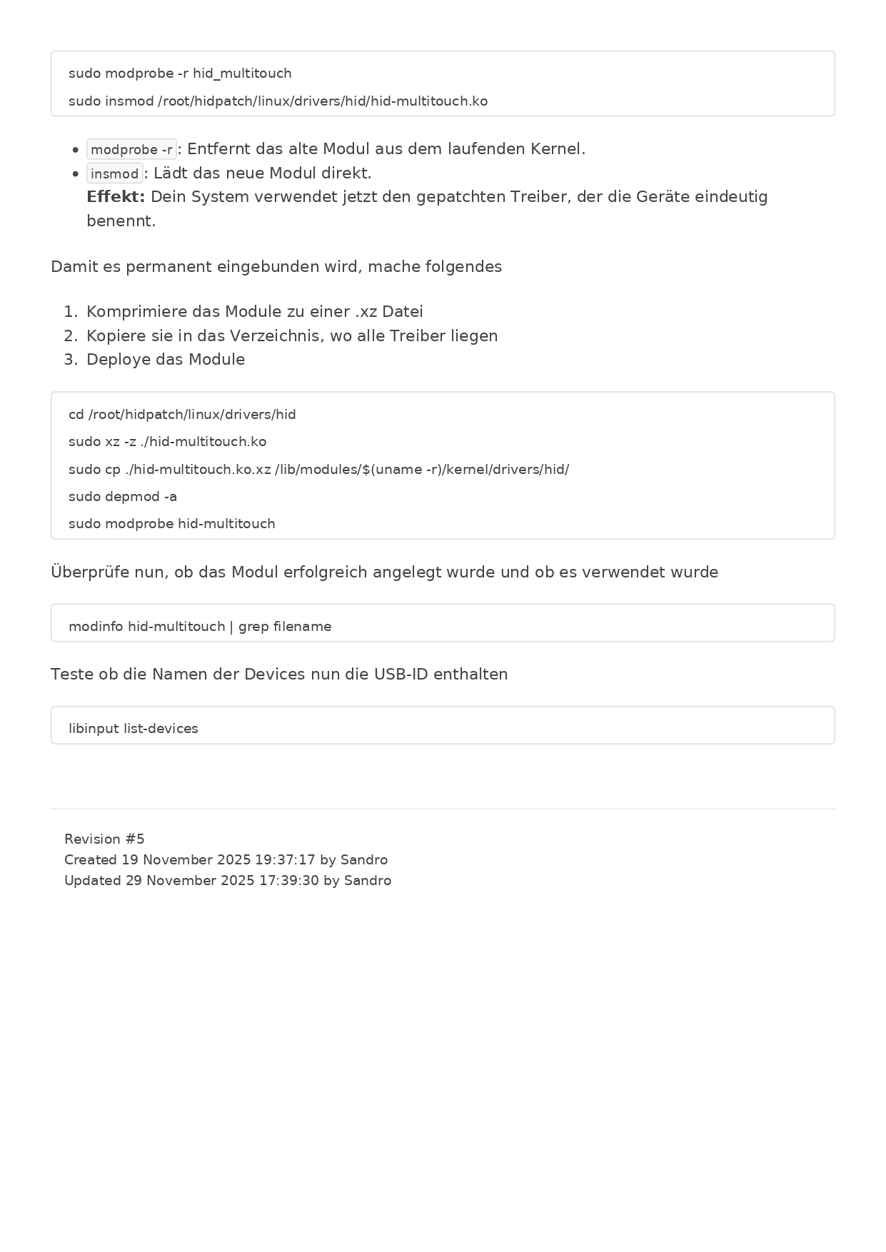

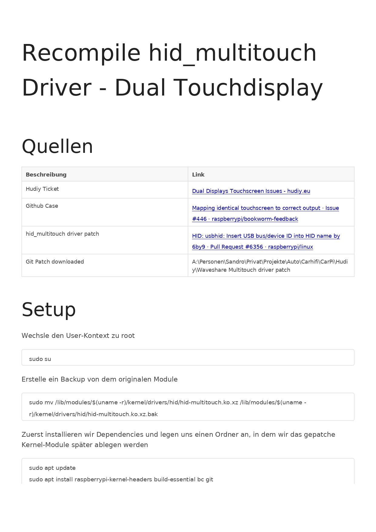

I also tried the patch for hid-multitouch driver. I really didn't know what I was doing, all ChatGPT. But I documentated all of my commands as you can see in the attatchments. The driver seems to not be used. The modified driver is called "hid-multitouch.ko" (and as a compressed version "hid-multitouch.ko.xz") and its safed at /lib/modules/6.12.47+rpt-rpi-2712/kernel/drivers/hid/. If I do "lsmod | grep hid_multitouch" there is a result. For "lsmod | grep hid-multitouch" nothing. I dont really know what to troubleshoot about this. I just saw something in dmesg, again one event with "hid_multitouch" and two other with "hid-multitouch":
sandro@hudiy:~ $ dmesg | grep multitouch
[    2.591638] hid_multitouch: loading out-of-tree module taints kernel.
[    2.668212] hid-multitouch 0003:0EEF:0005.0004: input,hiddev96,hidraw3: USB HID v1.11 Device [WaveShare WS170120] on usb-xhci-hcd.0-1.1/input0
[    2.776532] hid-multitouch 0003:0EEF:0005.0005: input,hiddev97,hidraw4: USB HID v1.11 Device [WaveShare WS170120] on usb-xhci-hcd.0-1.2/input0
sandro@hudiy:~ $ cd /lib/modules/$(uname -r)/kernel/drivers/hid/

    #Get unique ID_PATH of each touchscreen via - udevadm info /dev/input/eventX
    path=$(udevadm info "$devnode" | grep '^E: ID_PATH=' | cut -d= -f2)
    case "$path" in
        #touchscreen with ID_Path *usb-0:1.2* to HDMI-1
        *usb-0:1.2*)
            xinput map-to-output "$id" HDMI-1
        #touchscreen with ID_Path *usb-0:1.1* to HDMI-2
        *usb-0:1.1*)
            xinput map-to-output "$id" HDMI-2
    esac
done
The important value for you to find out is via 'udevadm info /dev/input/eventX', where the X represents the number of your device. You can find this devicepath via
libinput list-devices
Search for your touchscreen devices and find the string, which is called '/dev/input/eventX'
Now replace the X with the number and do a second, more advanced search with the devicePath of the device
udevadm info /dev/input/event4
