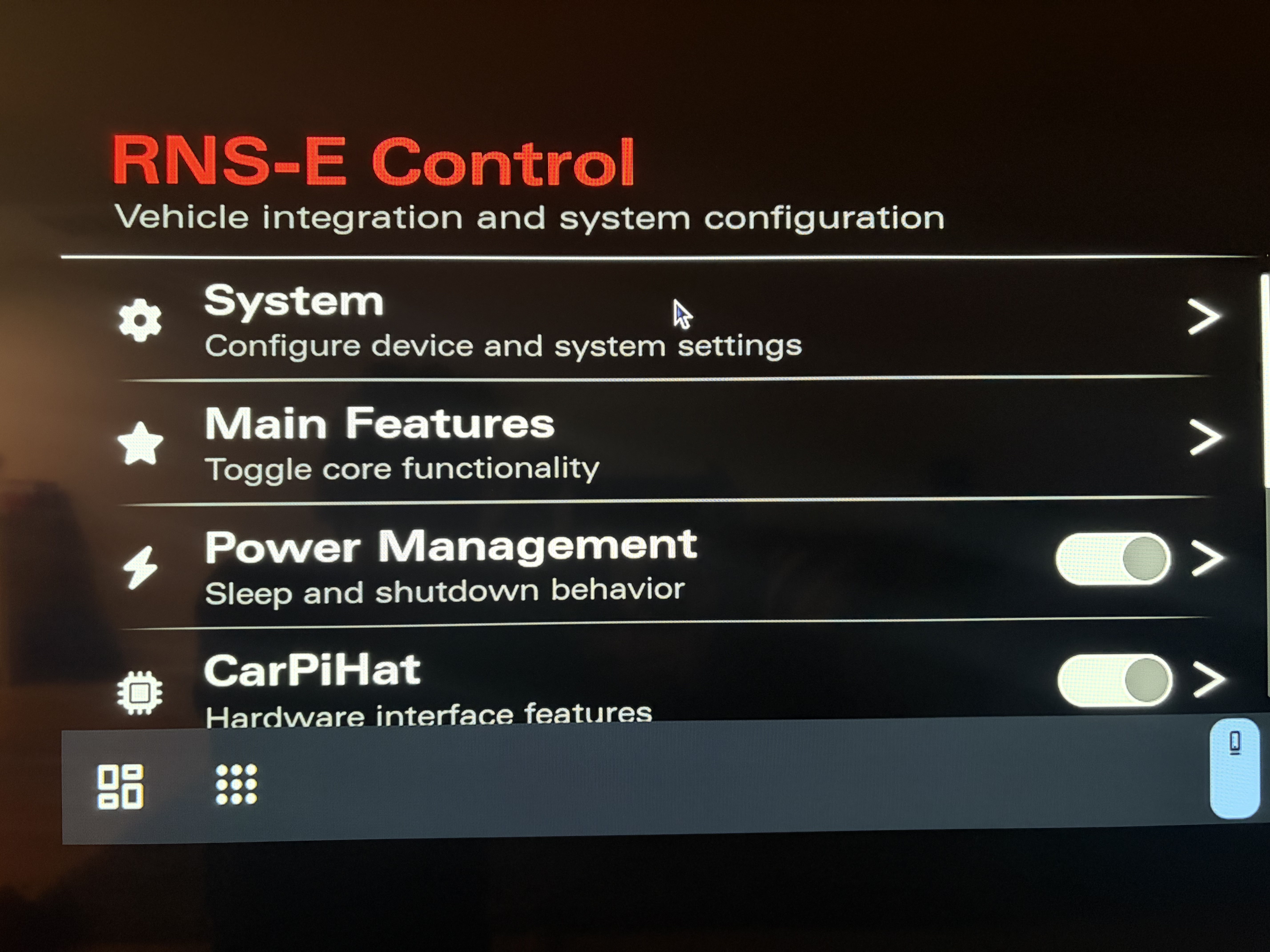

I’m trying to theme hudiy like the oem head unit graphics
I’m sure a lot of people would like more freedom to customize the look of everything. Some things I can think that would be great
Control bar look and location customization (top bottom left right or hidden)
System wide font and icon customization. Both look and sizing
More control of colors customization.
Completely removing dashboard.
Ability to change main menu style.

I’ve already build this for custom controls. When I load this on my head unit it looks a lot more squeezed so wanted to remove the control bar or move it to the left of screen.
I guess I’ll look into how to rebuild the entire UI with the API.
