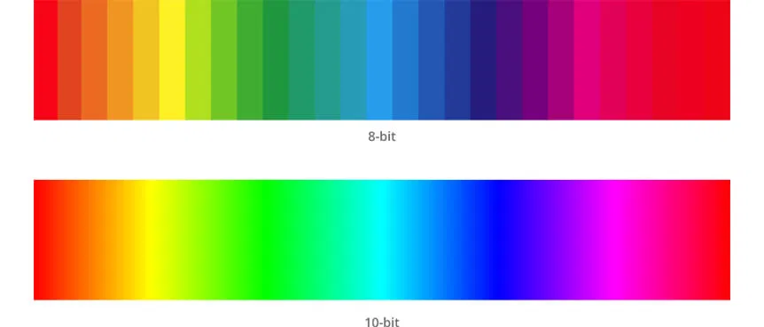

Edit:
Looks like CarPlay uses 8-bits for video stream encoding. The difference between 8 and 10 bits encoding is explained by this picture:
The "liquid glass" introduces more gradients and because of 8-bit encoding, some colors may appear with lower quality.
