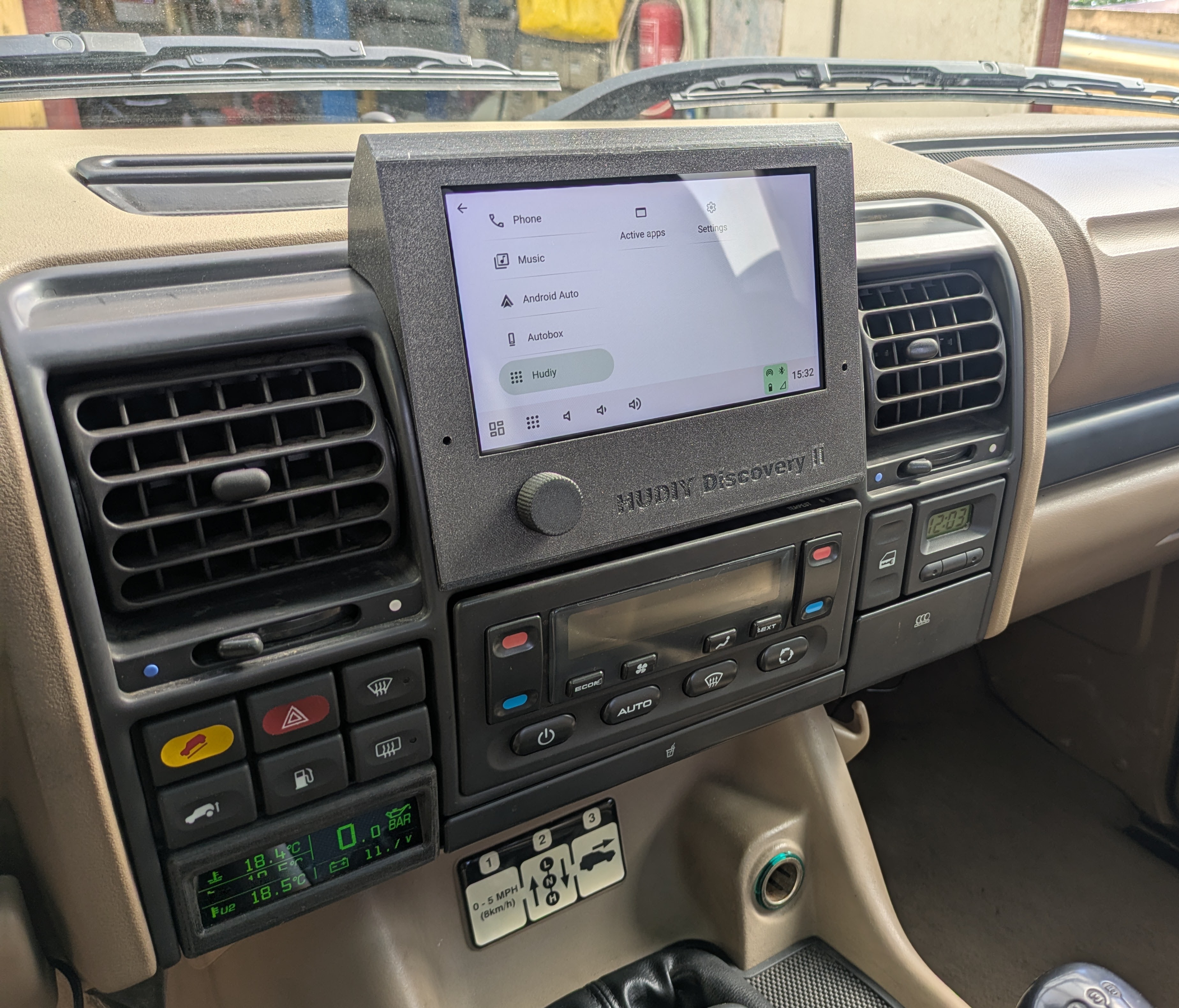

I have now ongoing project Land Rover Discovery 2. I created custom PCB with arduino nano for power management. Also it can handle heater(webasto) timing during the night. Inside my unit is 12V->5V step down and audio amplifier. Steering wheel buttons are connected and working.
In future I would like to implement widgets for:
- webasto timing interface
- XY inclinometer with I2C gyroscope

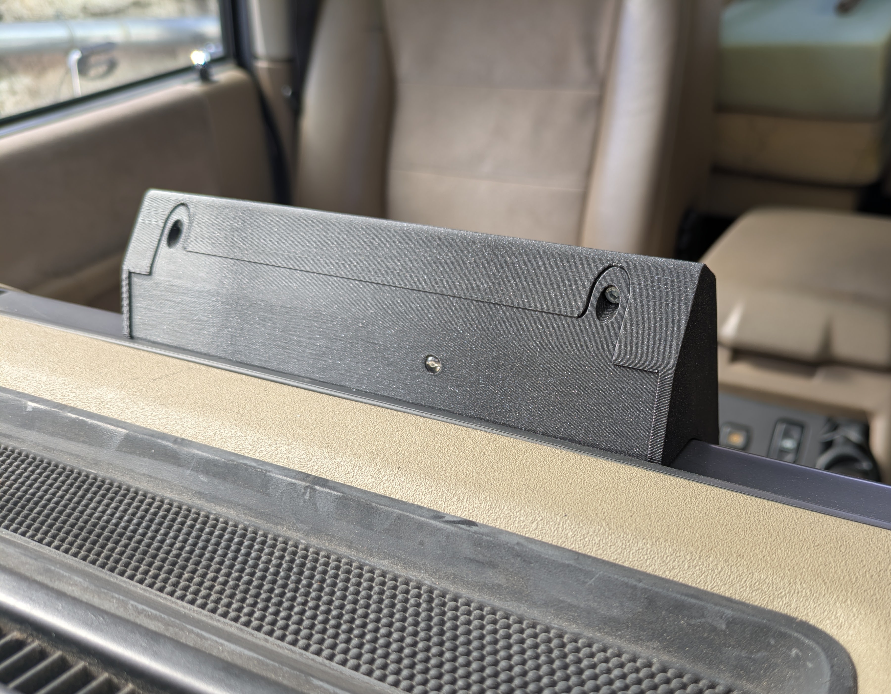

Mounting is done without any cutting to the original dashboard and hold firmly just with two hidden M3 HEX screws.
Rear side with light sensor for day/night + backlight control.

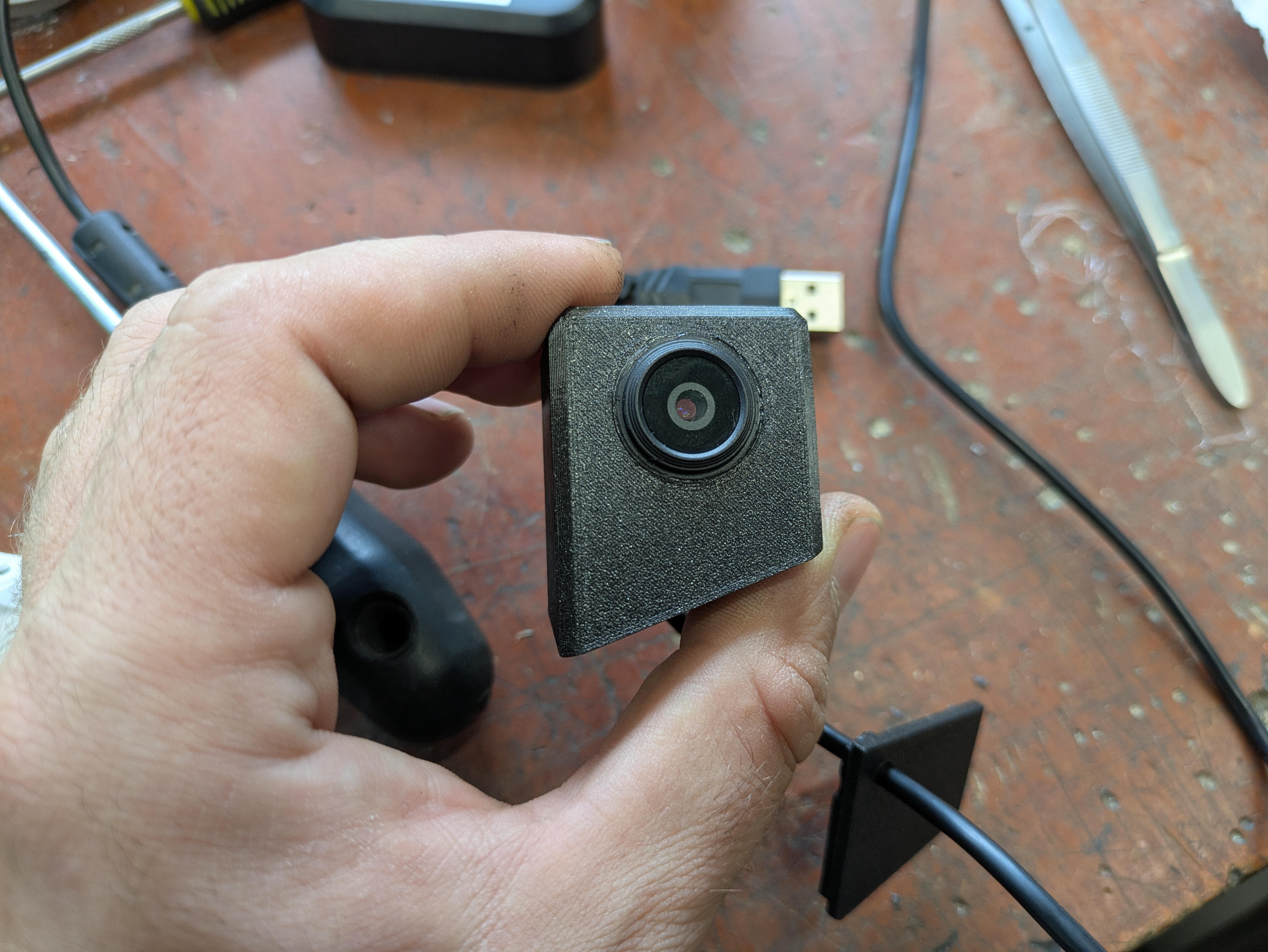

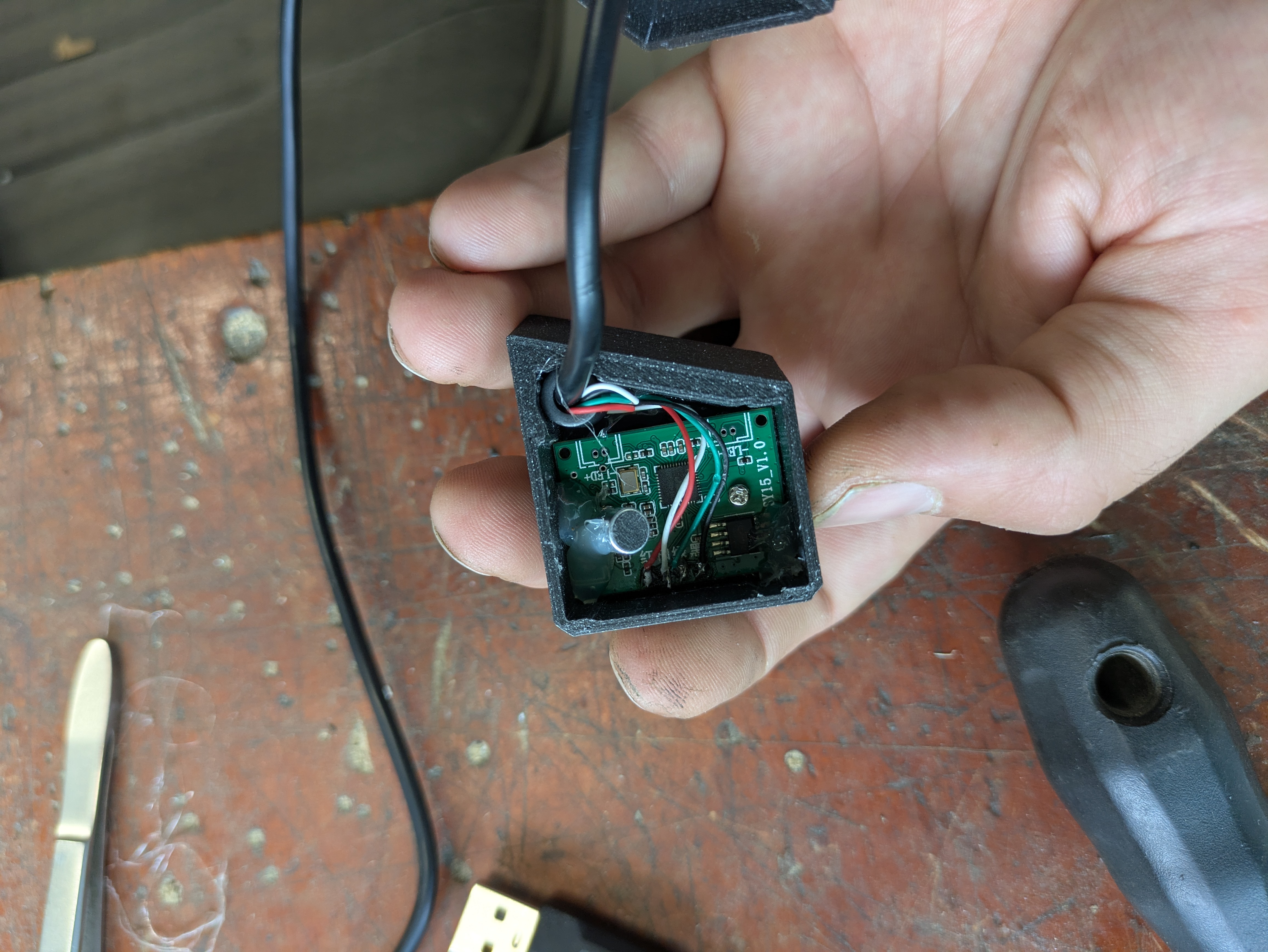

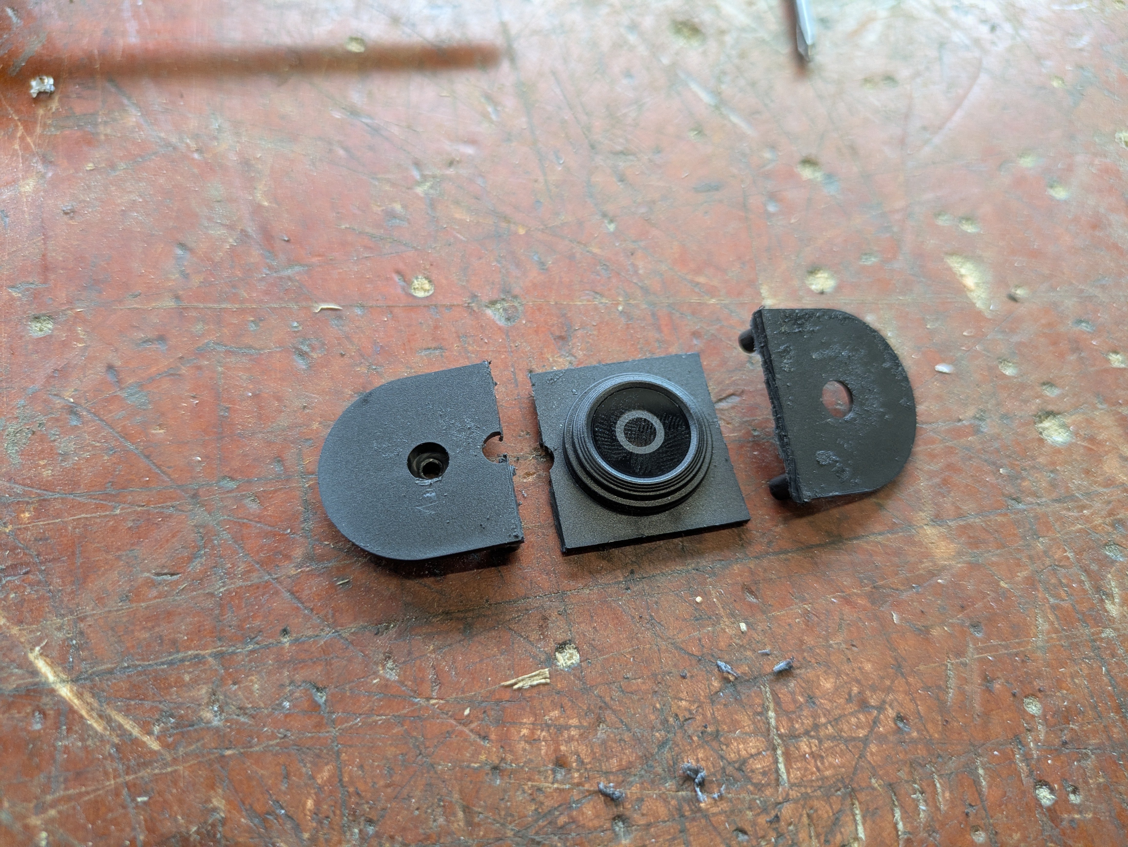

For inspiration.... also connected reverse USB camera. I reused old lens cover and put PCB to 3D printed case.

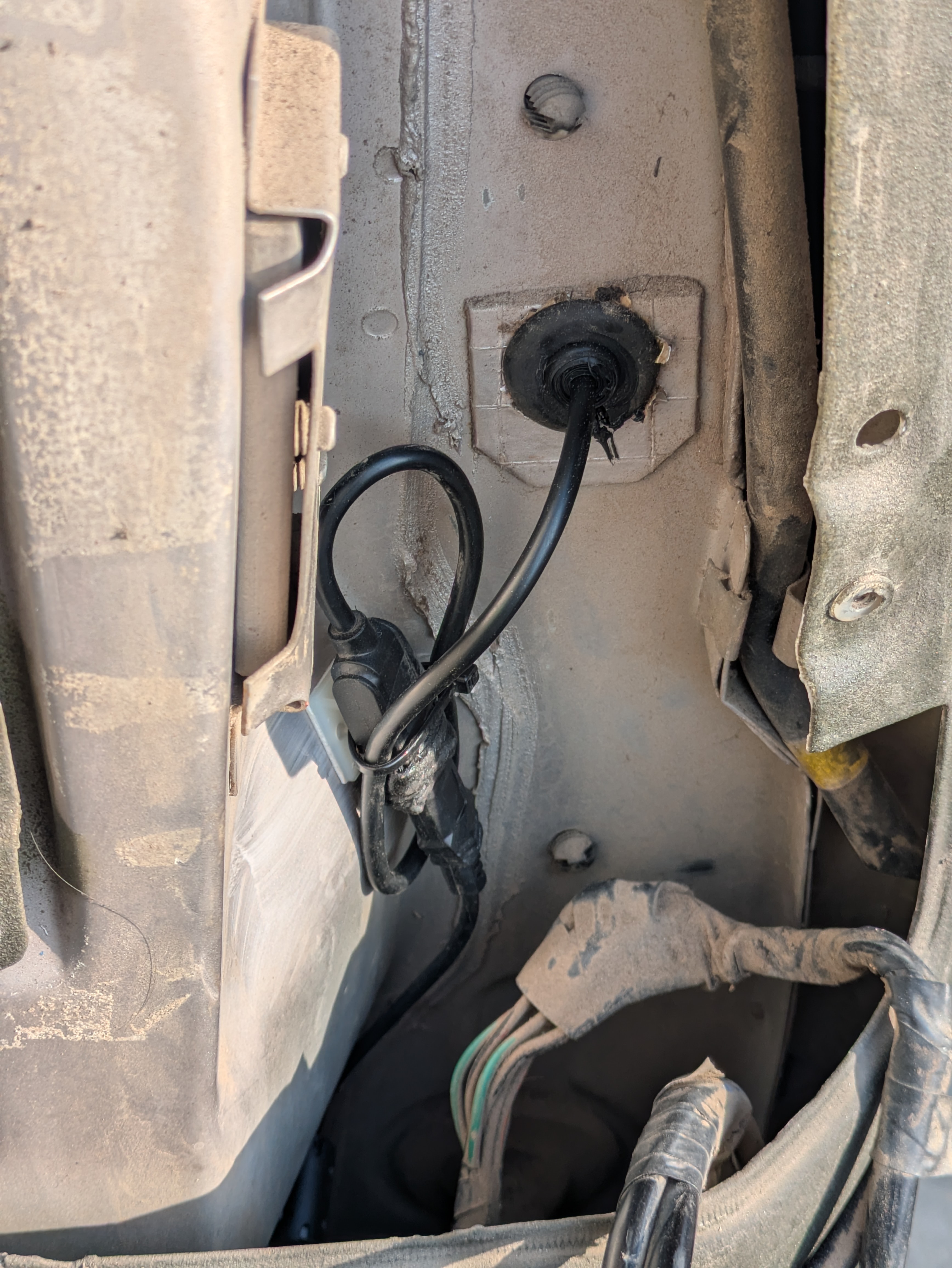

I routed USB extension cable from dash to behind rear light, so anytime camera can be simply replaced. Cable is waterproof isolated with butyl tape.
