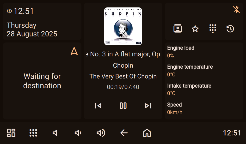

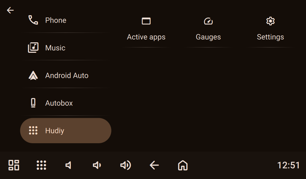

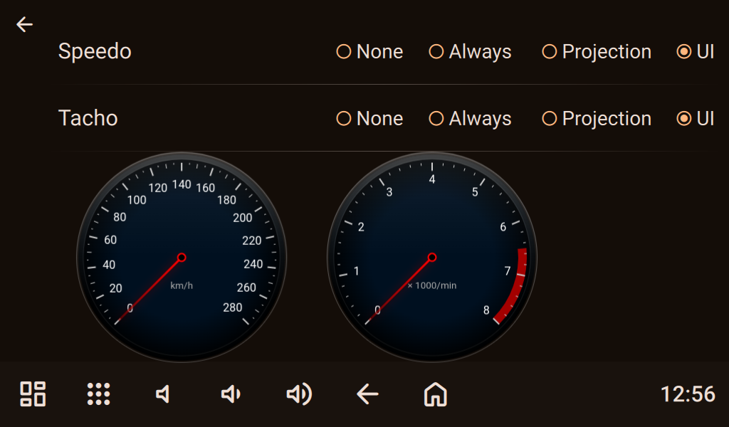

If you’d like to use the examples available on our GitHub, below we’re sharing configuration files based on the default ones. You can copy and paste them into the files in your installation (in $HOME/.hudiy/share/config). Note that the .hudiy folder is hidden (the dot before the name). To show hidden files in the Raspberry Pi file manager (pcmanfm), use the key combination CTRL + H (toggles hidden files on or off).
To run the HTML/JavaScript examples, you’ll need to configure ELM327 — the instructions are here: viewtopic.php?t=25

applications.json
    "applications": [
            "action": "obd2_gauges_app",
            "url": "http://127.0.0.1:12345/gauges.html"
applications_menu.json
    "categories": [
            "isDefault": true,
            "iconFontFamily": "Material Symbols Rounded",
            "iconName": "call",
            "label": "Phone"
            "iconName": "library_music",
            "label": "Music"
            "iconFontFamily": "Hudiy Symbols",
            "iconName": "\ue900",
            "label": "Android Auto"
            "iconName": "general_device",
            "label": "Autobox"
            "iconName": "apps",
            "label": "Hudiy"
    "items": [
            "categories": [
                "Phone"
            "iconName": "contacts",
            "action": "contacts",
            "label": "Contacts"
            "categories": [
                "Phone"
            "action": "favorite_contacts",
            "label": "Favorites"
            "categories": [
                "Phone"
            "iconName": "dialpad",
            "action": "dialpad",
            "label": "Dialpad"
            "categories": [
                "Phone"
            "iconName": "call_log",
            "action": "calls_history",
            "label": "Call log"
            "categories": [
                "Phone"
            "iconName": "phone_in_talk",
            "action": "active_call",
            "label": "Active call"
            "categories": [
                "Phone"
            "iconName": "notifications",
            "action": "phone_notifications",
            "label": "Notifications"
            "categories": [
                "Music"
            "iconName": "audio_file",
            "action": "storage_music_player",
            "label": "Storage Music"
            "categories": [
                "Music"
            "iconName": "cell_tower",
            "action": "fm_radio_player",
            "label": "FM Radio"
            "categories": [
                "Music"
            "iconName": "media_bluetooth_on",
            "action": "a2dp_music_player",
            "label": "A2DP"
            "categories": [
                "Music"
            "action": "autobox_player",
            "label": "Autobox Music"
            "categories": [
                "Music"
            "action": "android_auto_player",
            "categories": [
                "Hudiy"
            "iconName": "web_asset",
            "action": "background_applications",
            "label": "Active apps"
            "categories": [
                "Hudiy"
            "iconName": "speed",
            "label": "Gauges"
            "categories": [
                "Hudiy"
            "iconName": "settings",
            "action": "settings_menu",
            "label": "Settings"
            "categories": [
                "Android Auto"
            "iconName": "usb",
            "action": "connect_android_auto_usb",
            "label": "Connect USB"
            "categories": [
                "Android Auto"
            "iconName": "wifi",
            "action": "connect_android_auto_wifi",
            "label": "Connect WiFi"
            "categories": [
                "Android Auto"
            "iconName": "redo",
            "action": "resume_android_auto_projection",
            "label": "Resume"
            "categories": [
                "Android Auto"
            "iconName": "cancel_presentation",
            "action": "quit_android_auto",
            "label": "Quit"
            "categories": [
                "Autobox"
            "iconName": "wifi",
            "action": "connect_autobox_wifi",
            "categories": [
                "Autobox"
            "iconName": "redo",
            "action": "resume_autobox_projection",
            "label": "Resume"

                    "type": "date_time",
                    "size": "small_narrow"
                    "type": "navigation",
                    "size": "medium_narrow"
                    "type": "now_playing",
                    "size": "large_narrow"
                    "type": "phone",
                    "type": "web_static",
                    "size": "medium_narrow",
                    "url": "http://127.0.0.1:12345/obd_widget.html"
overlays.json
    "overlays" : [
            "identifier" : "Speedo",
            "action" : "",
            "width" : 300,
            "height" : 300,
            "x" : 0,
            "y" : 0,
            "visibility" : "NATIVE_UI_ONLY",
            "url" : "http://127.0.0.1:12345/speedo.html",
            "controlAudioFocus" : false,
            "audioStreamCategory" : "NONE",
            "visibleOnActions" : [
            "staticPosition" : false
            "identifier" : "Tacho",
            "action" : "",
            "width" : 300,
            "height" : 300,
            "x" : 0,
            "y" : 0,
            "url" : "http://127.0.0.1:12345/tacho.html",
    "navigationOverlayPosition" : {
        "x" : 0,
        "y" : 0
    "volumeOverlayPosition" : {
        "x" : 0,
        "y" : 0
    "navigationOverlayVisibility" : "NONE",
    "volumeOverlayVisibility" : "NONE",
    "navigationOverlayOpacity" : 100,
    "xStep" : 20,
    "yStep" : 10
