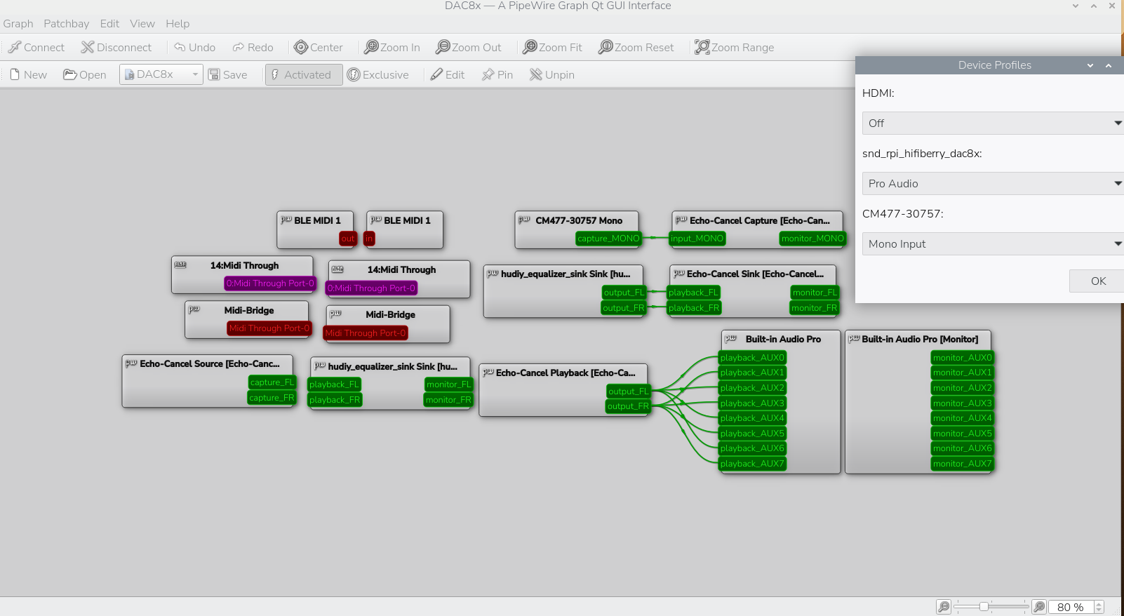

it is working now after I tried a freshly setup Trixie with Hifiberry DAC8x. I'm not sure if my earlier Bookworm has too many qpwgraph file interrupted the setup. anyway, will try out if it works. here is what I did:
Driver: Add dtoverlay=hifiberry-dac8x to /boot/firmware/config.txt to enable the DAC8x.
sudo apt install alsa-utils
# For PipeWire setup
sudo apt install pipewire-audio-client-libraries pipewire-pulse wireplumber
Create: /etc/pipewire/pipewire.conf.d/99-hifiberry-dac8x.conf
copy these"
context.objects = [
{ factory = adapter
args = {
factory.name = api.alsa.pcm.sink
node.name = "DAC8x"
node.description = "DAC8x"
api.alsa.path = "hw:sndrpihifiberry"
audio.channels = 8
audio.format = "S32LE" # Or S24LE
audio.rate = 48000
restart Pi. go to desktop mode and right click the audio icon --> device profile --> enable Pro Audio.
then go to qpwgraph to remap the audio links as shown.
then in the hudiy_startup.sh: add this
qpwgraph --minimized --activated --exclusive saved_routing.qpwgraph &

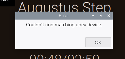

I don't think it is because of the DAC8x issue somehow I get this udev thingy notice after I plug in my phone running Android Auto. I remember I don't have such during my early trial of Hudiy. however I get this a lot in OpenAuto Pro.

This popup comes from pcmanfm (Raspberry PI file manager). Pcmanfm tries to mount connected USB device as an MTP drive. You can disable it in pcmanfm settings.
viewtopic.php?p=570#p570
