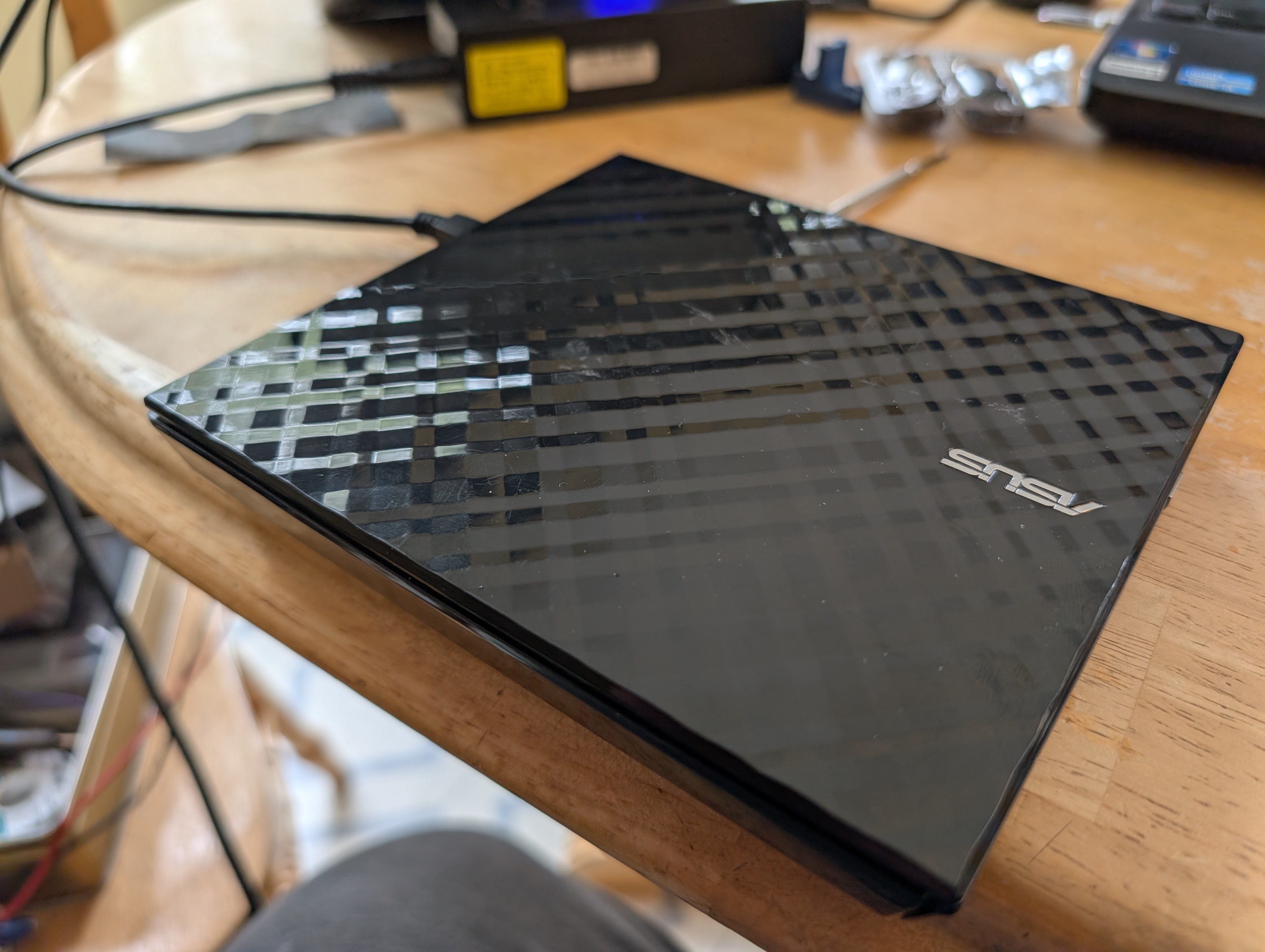

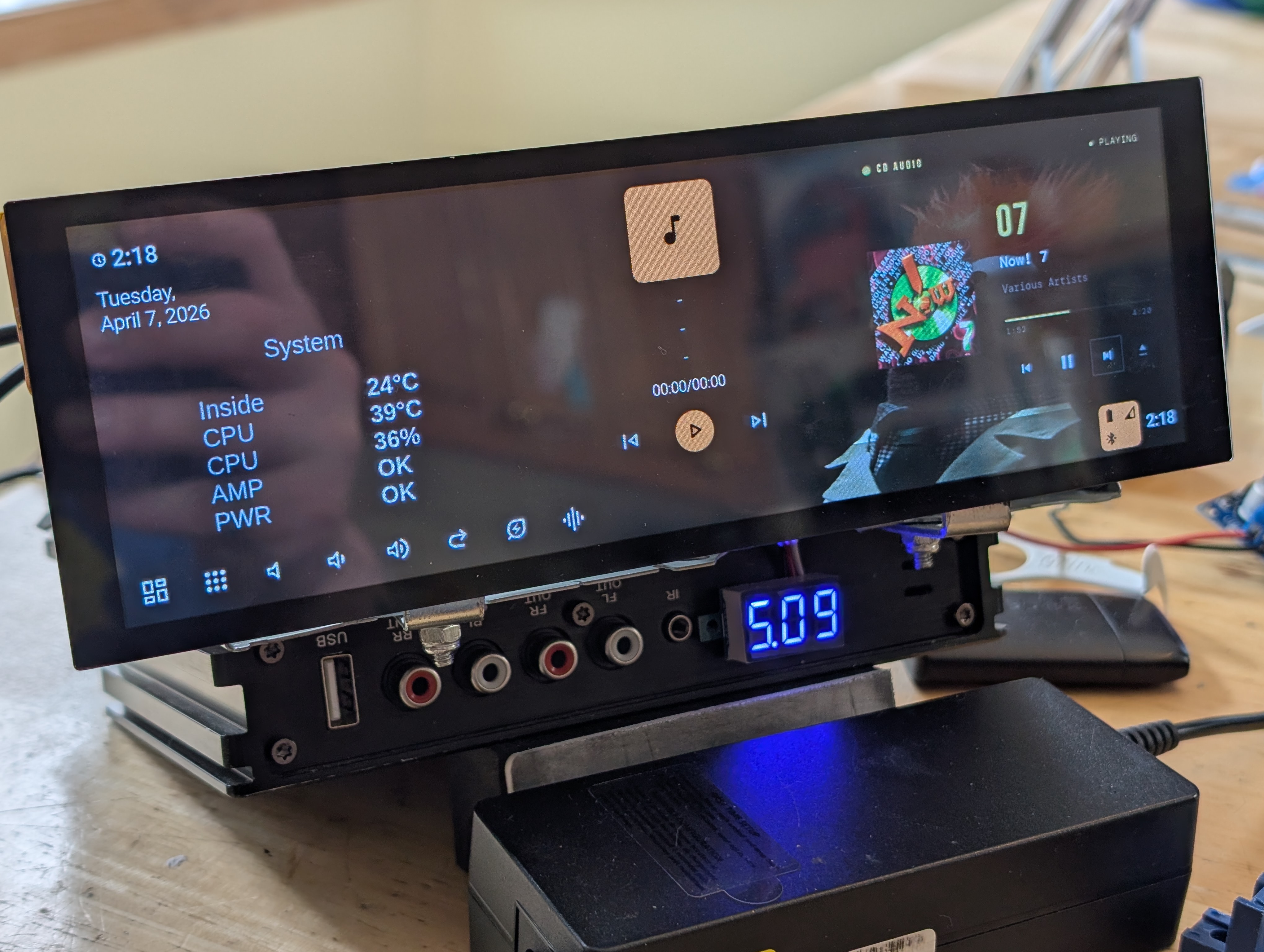

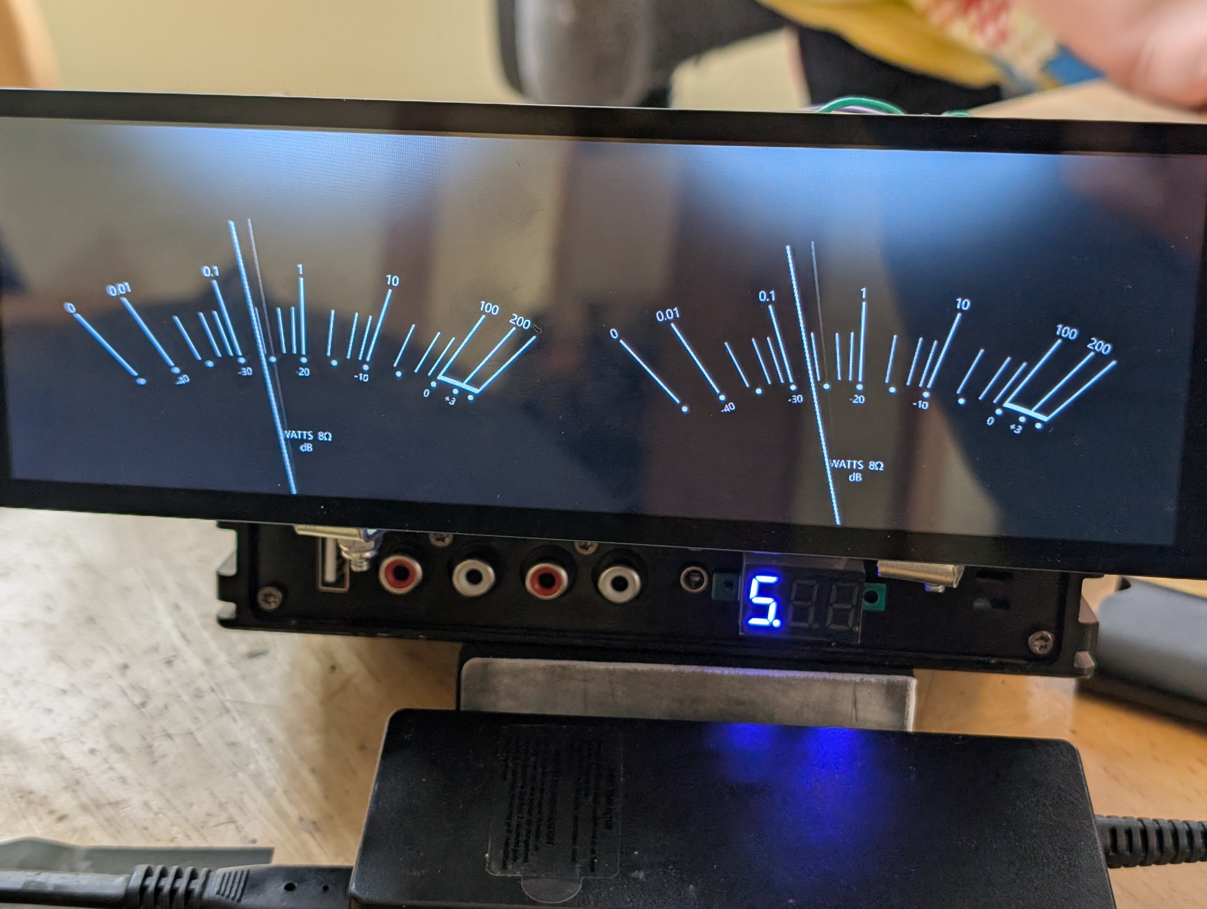

Small changes. Changed the dashboard, and added an optical disk player. And added peppymeter
The disk player pictured is for testing only, not the final product. Big changes coming in the next few weeks..

A couple python files, a service file and an html. I've tried posting a "how to" for this and the peppymeter but an error prevented me from attaching the files.
Down side to the cd player is power, you will need external power, and I wasn't able to use the existing "now playing" dashboard. I had to make a new one.
