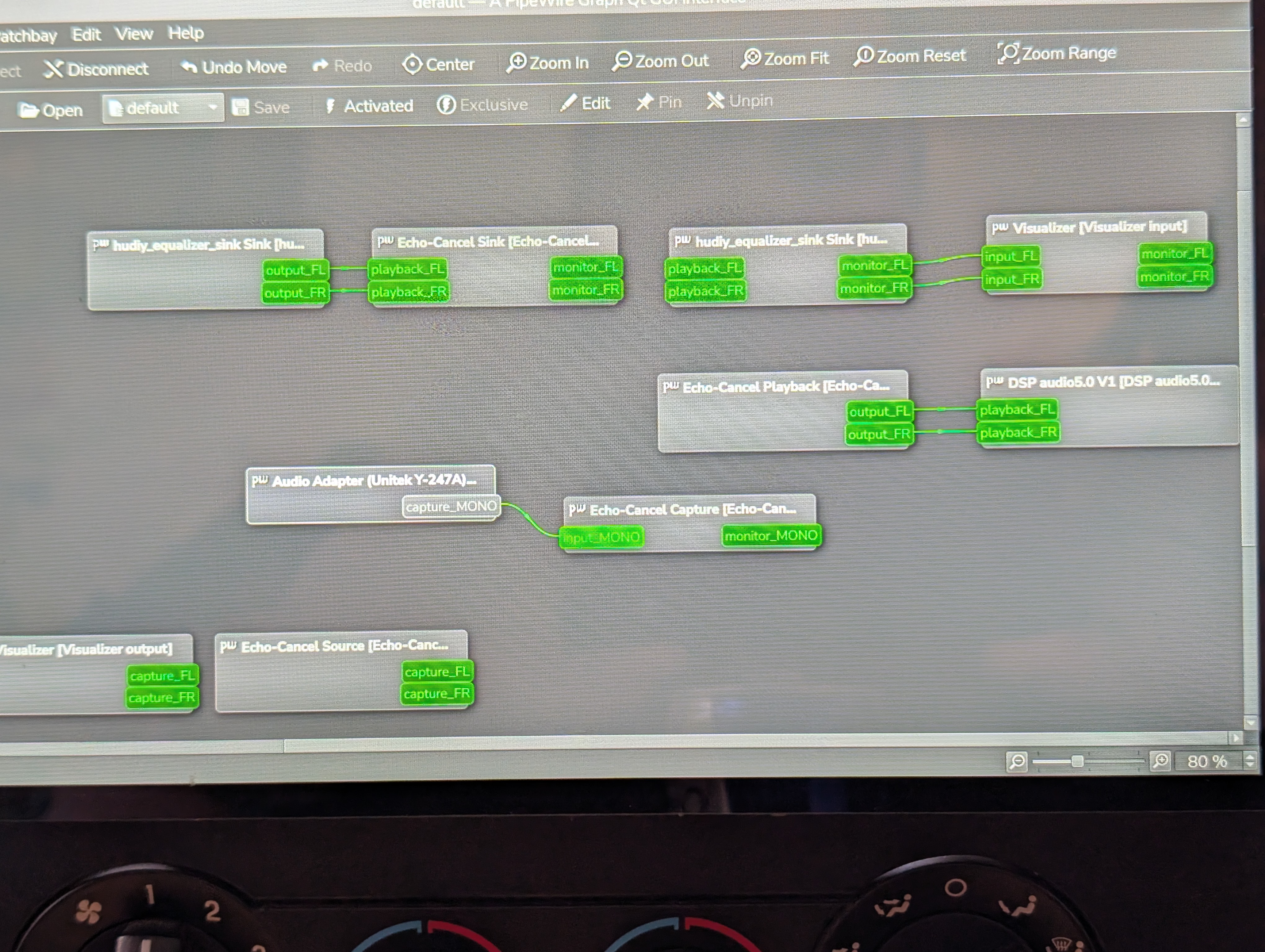

Now i understand why qpwgraphs flow looks the way it does after boot. Its the correct way.. I get audio now for some reason, it is crackly and a little quieter than expected but it seems to work. idk why now and not before.
Any ideas into the crackling at volume change? it seems to be the most audible while AA is open.

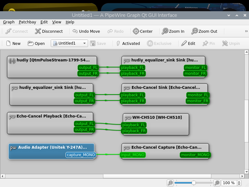

Re: After 2.4 update
We tried to reproduce your setup. We connected headphones instead of a Bluetooth amplifier, but it should work the same way from PipeWire's perspective. Everything worked out of the box and we didn't observe any audio glitches. The routing generated by PipeWire looks identical.

hudiy wrote: Sun Jan 25, 2026 5:48 pm We tried to reproduce your setup. We connected headphones instead of a Bluetooth amplifier, but it should work the same way from PipeWire's perspective. Everything worked out of the box and we didn't observe any audio glitches. The routing generated by PipeWire looks identical.
Could it be that I dont have a defined source? I see you have the qtm-pulse stream.. set as input to the hudiy_equalizer_sink.
QtmPulseStream on the screenshot is just a sink input (in this case from Android Auto). Sink inputs appear automatically once you start playback in any app (Hudiy, web browser, vlc, etc).
We also checked the PipeWire GitLab and found several issues regarding Bluetooth devices where volume control doesn't work. It’s possible your amplifier is one of those devices:

Some weird behavior, audio still wont automatically play through the bluetooth dsp. A few days ago i could get audio to work by selecting the dsp in the audio dropdown and then going into Hudiy. This is qpwgraph after selecting it https://imgur.com/sVEixzk and here is a video and a few pictures showing what qpwgraph looks like immediately after exiting Hudiy.
https://imgur.com/SeZscUk https://imgur.com/B8bxgiU https://imgur.com/FV2T0Rz
https://imgur.com/5JgQQvu
However, now, (I changed nothing) I still have to select the dsp from the dropdown but qpwgraph looks like this https://imgur.com/vvHOFVj and it looks like this after exiting Hudiy https://imgur.com/cGkRdHA
Does your amplifier always connect to Bluetooth before Hudiy starts? Looking at qpwgraph, it seems like sometimes the echo cancel and equalizer load before the amplifier connects, causing WirePlumber to create different routing.
You could try adding a wait for a specific sink before Hudiy starts. Alternatively, you can specify a specific master for the echo-cancel module:
hudiy_startup.sh
AMP_SINK="bluez_output.E9_A7_26_03_1E_82.1"
while ! sink_exists "$AMP_SINK"; do
done
sink_exists "$EC_SINK" || pactl load-module module-echo-cancel aec_method=webrtc aec_args=\"voice_detection=false\" source_name="$EC_SOURCE" sink_name="$EC_SINK" sink_master="$AMP_SINK"
Also remove the wireplumber cache:
cd $HOME/.local/state/wireplumber
rm -rf *
